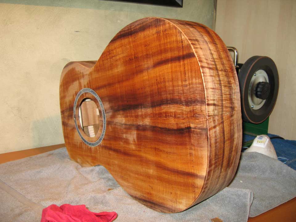

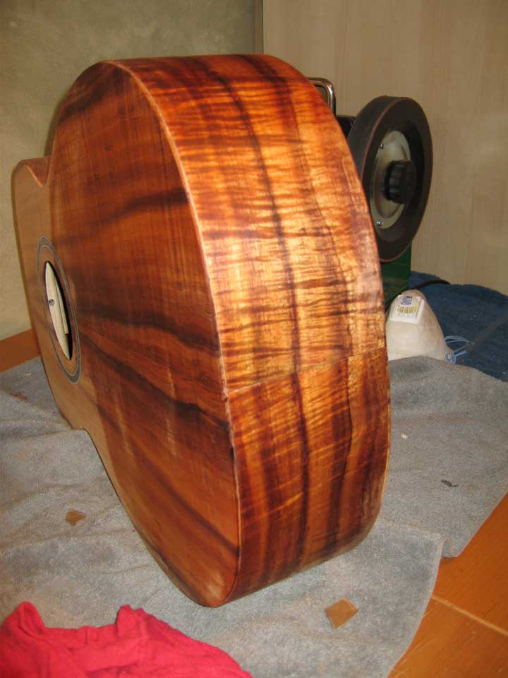

A year ago today I started my first guitar from scratch!!!!!!
Now I am on number 10...wooooooohhhh doggggieeeeee.
TOTALLY HOOKED.
I could dwell on how I carved into the CF rods on a neck or other bone
head mistakes, but why...
I have been trapped by a great hobbie!!!!!! Great friends!!!!!! An awesome
OLF group!!!!!!An understanding wife!!!!!! and more orders that I can deal
with. I am very blessed.!!!!!!!
Just my 2 cents.
Andy
Picts below are #10
An OM 14 ALL KOA!!!!! Left handed.
